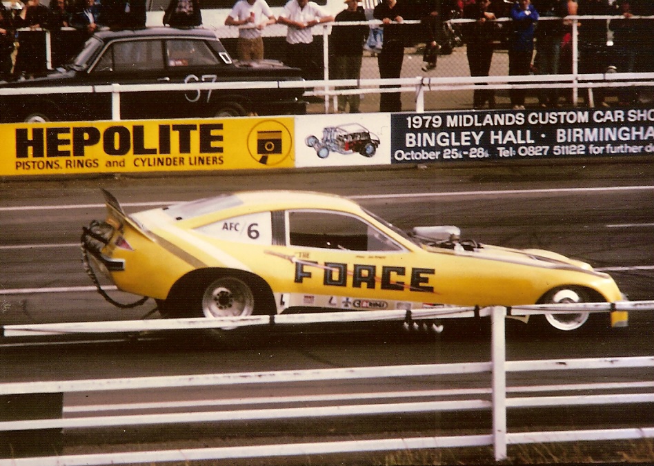

And for next year and just to be part of the overall package he is putting an old style injector on and changing the rear wing so that the 1971 Beetle looks the part. And for those of you that are old enough to remember (which I do lol) Andy’s chassis is the old Gene Snow Monza/Ron Picardo/Mark Needam car with updates from Roy Wilding, Nostalgia FC it is, Nitro it’s not.

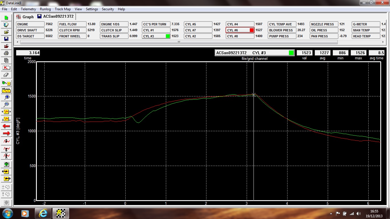

Two egt traces. Cylinder 6 is red and looks o.k. Cylinder 3 is green and has given us a little trouble. It drops out for 2 - 3 tenths of a second about 2 tenths into the run. Cylinder 5 is doing a similar thing but is a little worse, on this run however, it was o.k. and is thus not shown.
After the car has backed up from the burnout and all the normal stuff is taken care of it's probably been idling for over two minutes when Tim finally pulls into stage. Because of the nature of this type of engine there is no possibility to 'clear it' in pre-stage as one would an alky car or a Pro Stock car. Getting the engine to fire all 8 cylinders when Tim steps on the throttle is one of the more significant challenges.
I can't think of much else from this file that's particularly interesting so I'll stop here. If anyone wants anything else just shout and I'll post it up.

Apologies Charlie if you misunderstood what I said in my comment regarding your car - what I meant was that it was a surprise to me at Dragstalgia when you had the 'Vette body on the car as no one had ever mentioned that you were planning to put it on and as far as I knew it was still sitting in your yard. Similarly my comments regarding Andy's car were based on the assumption (I know, never assume) that as it normally runs in a bracket class it would have been assembled with this in mind - MSD ignition, PG or TH auto box with Trans brake, rather than with a Mag, clutch & Lenco which would make a shift over to NFC rules in 2016 a bigger hurdle as there would be more to change. As you pointed out it is a genuine fuel funny car chassis (always wondered where that one went - question answered) which makes it another rare survivor.

Rob wrote:I have no reference data but I believe our egt's to be higher than average ( for this type of engine ) when the car is idling. We run the idle quite lean because I'm a tight a**e
Hard to tell from your graph what your idle temps are (unless your reading temps in RPM rather than F :D )
As for being a "tight a**e" as you put it - I did hear someone make a comparison to a duck once :lol:
 #35528  by Rob
You're a hard man Paul, a hard man...
I did clarify the egt's in my last post.

Just to clarify Paul,andys car runs a super mag,yes he runs a p/g,have you seen how quick cars are going with glides and autos,and with the hp the same hp NFC motors are making !!!!,he doesn't launch the car off the trans brake,he brakes and whacks it,no different to a proper car,the car ain't got any tricks or gadgets on it,it's an old school set up,I should think the blower and mag where used in the war lol
