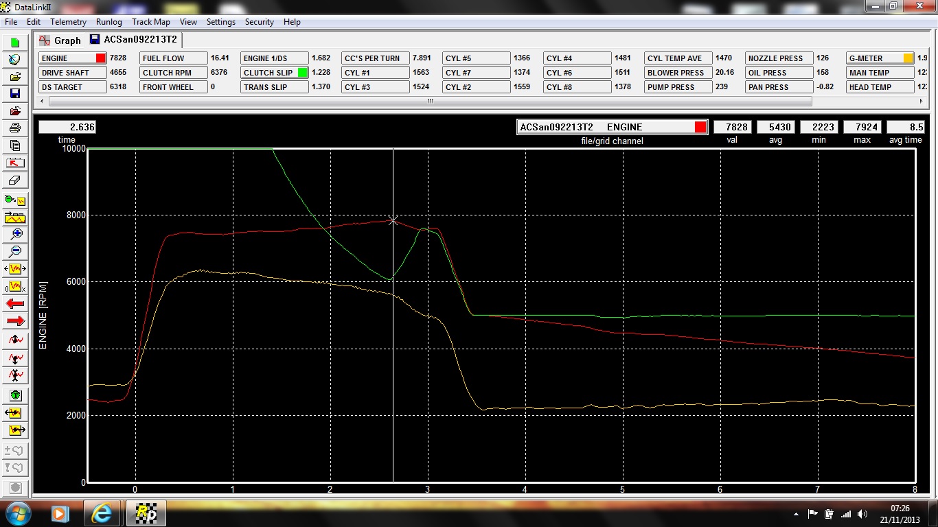

torment, jaytee shout if you want a trace of a particular channel from this file posted up, there's a mile of data to look at. If you try and put too much on the screen at once it just looks like coloured pasta so try and keep it to three channels. I don't have internet at home or a smartphone ( I know I know ) so the posts will be late afternoon when I'm done working.
This is the same part run. Now the rpm is red, clutch slip is green and the G-meter is yellow. The vertical white line is positioned at the gear shift. The clutch hadn't locked, Tim shifted, the clutch started to separate and the G-Meter took a dump.
80% nitro ( by volume ), 1.44 transmission, 3.89 rear, 34 1/2" tyre, 6.6 :1 compression, 19% O.D. and 53 degrees ignition.
It's not perfect but we're closing in on our base set up. Target E.T. is around 6.45 at 215.

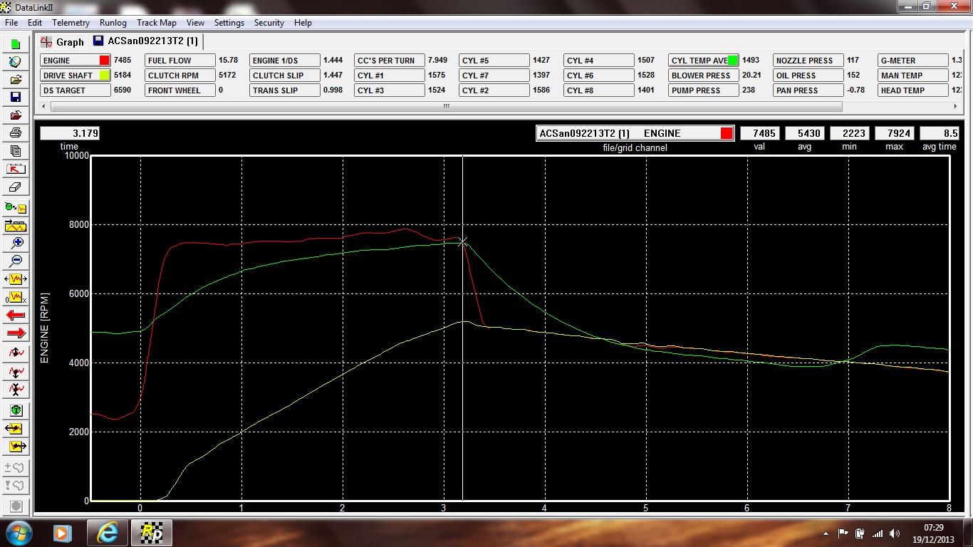

Same data file. Engine rpm is red, exhaust gas temp ( deg. F ) is green and the driveshaft ( prop. ) is yellow. I have no reference data but I believe our egt's to be higher than average ( for this type of engine ) when the car is idling. We run the idle quite lean because I'm a tight a**e and most of the fuel is used while the car is idling. Idle speed is about 2,800 to 3,000 at which point the engine uses about 1.6 gallons per minute ( gpm ).
