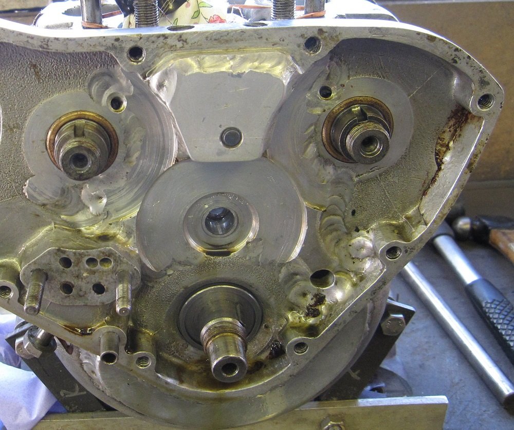

 #40417  by oily bike bloke
Pulling the engine revealed a lot of strengthening had been added to the cases. Someone had put a serious amount of time and effort into building the motor.
Strengthening was impressive - Oily BB
