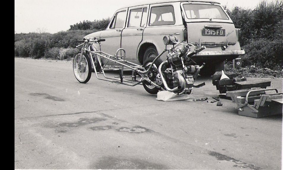

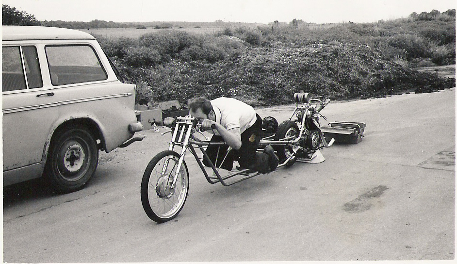

Does anyone have any recollection of my fathers bike called - " REVELATION 1 " that ran for approximately 3 years at Santa Pod roughly between 1969 - 71 , possibly number DCS 12 . These pictures were taken at Desborough airfield Northamptonshire on its very first outing .It did all he thought it would do until he lost his nerve to ride it at over 110 mph at the pod !. As far as I know only Dragwaye came close in the scary rider stakes. Dad said it was exceptional in the 1/8 but scared the hell out of him in the 1/4 however he lived to tell the tale & continued racing upto 1975 tuning and building many other contraptions ( including Revelation 2 & 3 ).
Revelation 1 Desborough

Revelation Engine Detail

I am slightly bemused by the pictures posted above.
There is a picture of mine of this bike in my book, but with the engine in front of the back wheel.
I am positive it is the same machine basically, but find it hard to believe it would have run at a proper drag race as shown in these pictures. Then again, I might well be proved wrong.
The rider's face is not clear - but I am assuming it is Irvine Laughton.

What scary looking ride,anymore photo's,I'd say you're right Keith the front of the bike and the engine with the Wal Philips injectors are the same as the bike in your book,it also featured on the cover of an early National Drag Racer

The engine in front of the back wheel bike was in fact "Revelation 2". The one shown in the pictures came first and ran at the pod for almost 2 seasons .There was alot of rain then and loads of meetings were a washout but infact this strange contraption was rideable .It did over 90 mph at it's very first meeting & proved very reliable and finally achieved an ET of 13.4 . Most terminal speeds were around 105 mph . This tuned Triumph ran straight methanol with modified Wal Phillips . I am not sure whether anyone else was ever crazy enough to try this layout .It was based on certain engineering principles and a dream .The quest for knowledge .The pod has always been bumpy at the top end with the wind mostly from the right side ( Westerly ) . 110 mph was possible but only on a good day ( underpants willing ! ) . Thanks for taking an interest . I have never seen a picture of it smoking away from the line with wheelspin in 2nd gear . My dad never thought he was infamous ! .But now looks forward to checking out the Kal book .
