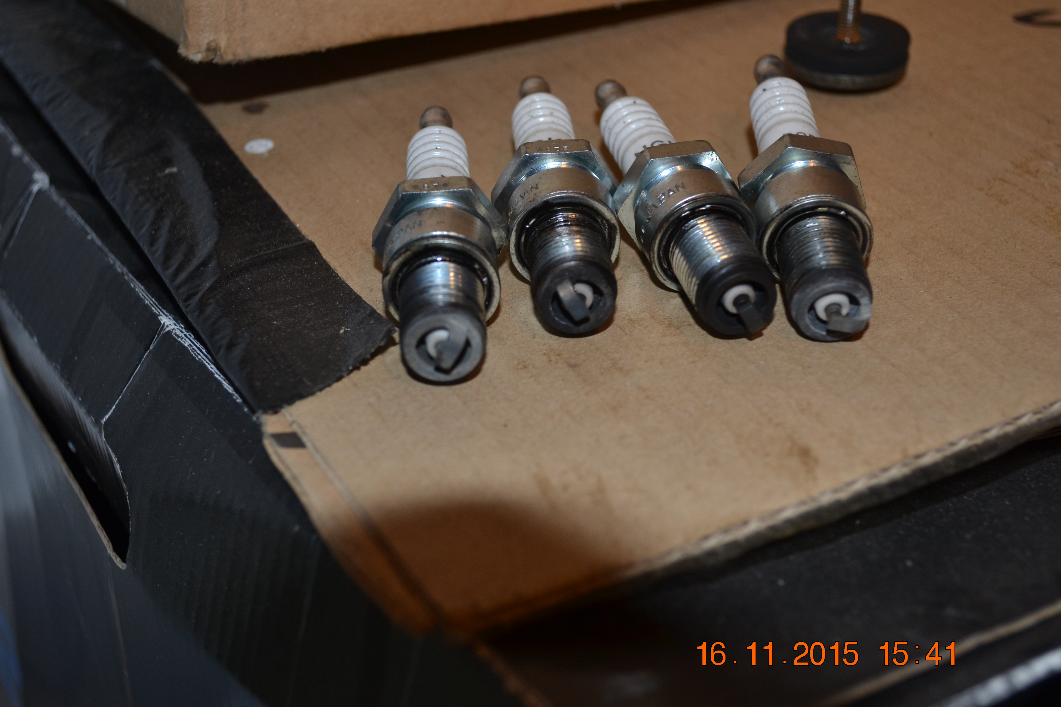

Finally found some time to getr down to RDR HQ in deepest Kent & start investigating the various issues that we found this year. First to do was a leakdown test on the engine to see if we could find what was causing the excessive oil venting into the catch can. After taking out the plugs I found one possible clue as you may tell from this pic? Left to right is cylinders 1 to 4.
Next we did the leakdown tests & disovered a probable blown head gasket between cylinders 2 & 3 , confirmed by the above pic, I think! There was also seemed to be more air leaking past the rings & creating excessive crankcase pressure, so the decision was made to pull the engine for a teardown as it would be easier to do out & also make getting the trans out a lot easier, if not essential!!

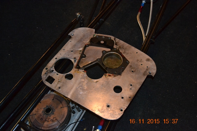

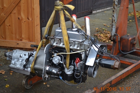

After a lot of trial & error we finally removed enough peripheral stuff to enable the engine/trans to be pulled out in one go.

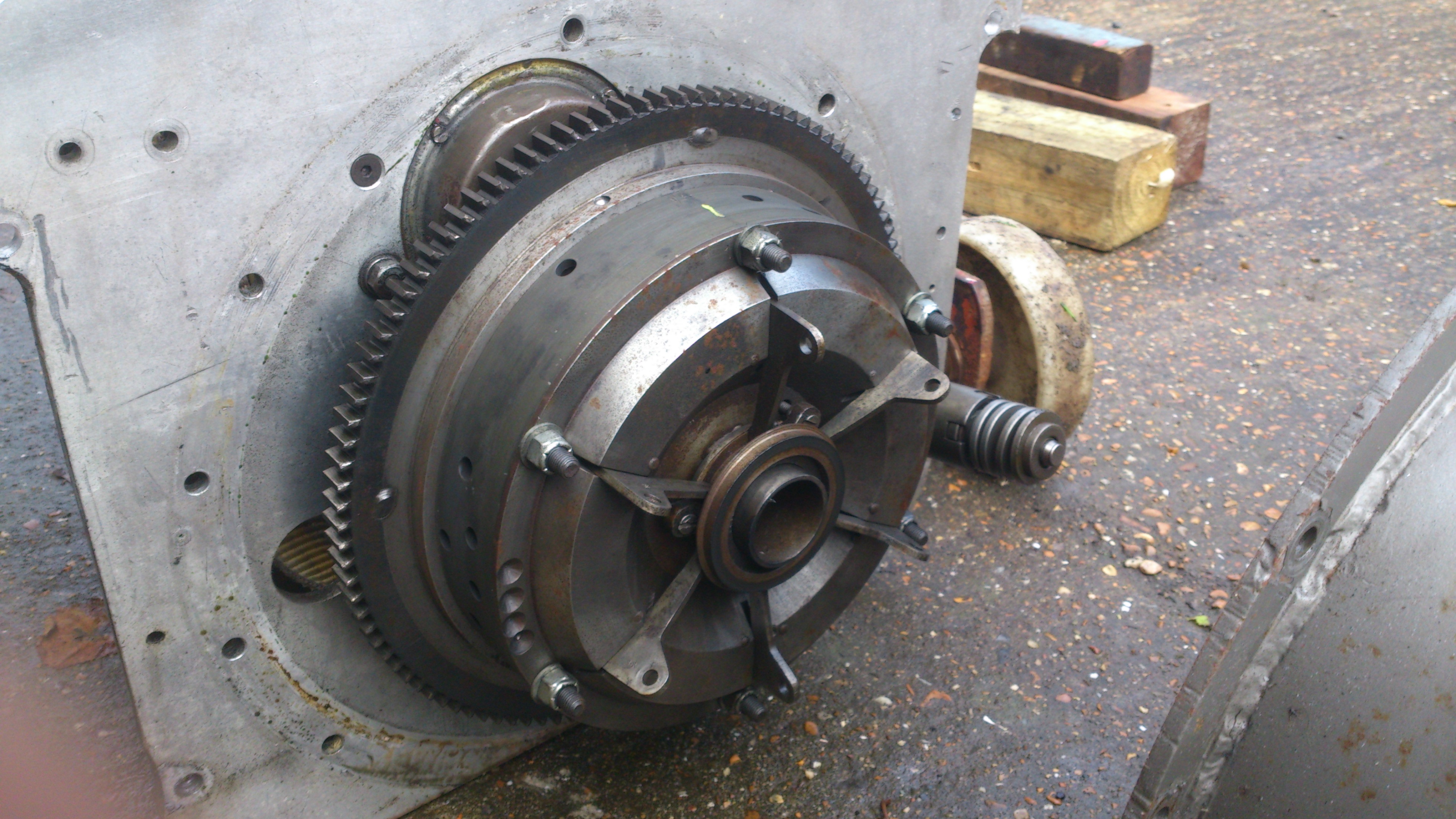

Now it was out, we could set about splitting the two & after a bit of faffing about removing even more bits of throttle linkage, we managed to get the trans & clutch can off. Taking the clutch apart it all seems good in there & was interesting to examine. After finally getting the starter motor off (it seems to be the first & last thing), we got the motor plate off & got the motor settled down on the ground. As the day was rapidly going by we tried to get the engine mounted on an engine stand but because it's such a tiny one (the engine!) it wouldn't fit any combination of arms & the protruding cover for the end of the camshaft also got in the way rather. So we decided to store it away until Dave can find time to make up some sort of adaptors to mount it. One interesting thing we discovered was the motor plate had a gasket seal on the back around the cam area.

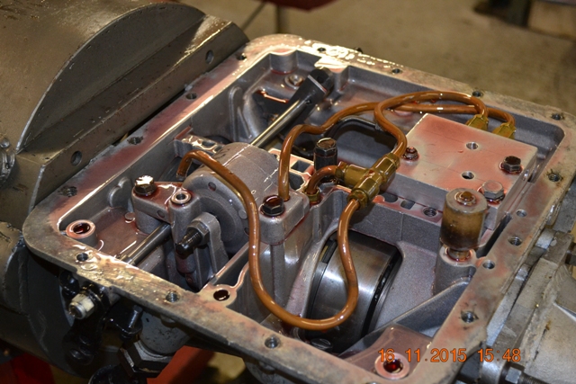

As I wanted to see inside the trans, we mounted it on the engine stand & drained the oil out into a humungeous drain tray Dave had (thanks Bob!) & turned the trans over & removed the sump, revealing what we believe to be the cause of the gear selection issues!! See if you can spot it?
Maybe this one is clearer?

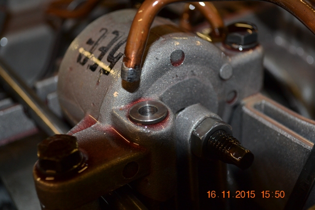

As was suggested by Mike Tomlin, a copper pipe was loose from it's proper home & therefore not supplying fluid to the servo when selecting 3rd gear & it had obviously happened before as there are signs of solder on the end where it fits into the valve body, presumably an attempt to make it a tighter push fit. Also, there is a flat worn on what is the underside of this pipe where it has obviously been rubbing on the sump, so we will be refitting this pipe & making up a pair of retaining brackets to hold it & the other pipe in their rightful places to ensure this doesn't happen again! Aside from this, there seemed very little else out of place or untoward, so hopefully this will solve the trans problem, fingers crossed.

I have no doubt that the gearbox issue is down to the dislodged pipe - which is an easy fix. It's been good to look inside the 'box etc. as until now they have been a bit of a mystery, and while I had a clue as to what was going on I couldn't be sure. The clutch is an interesting piece of work, and at this time doesn't allow for much in the way of adjustment as there are no weights currently on the fingers.

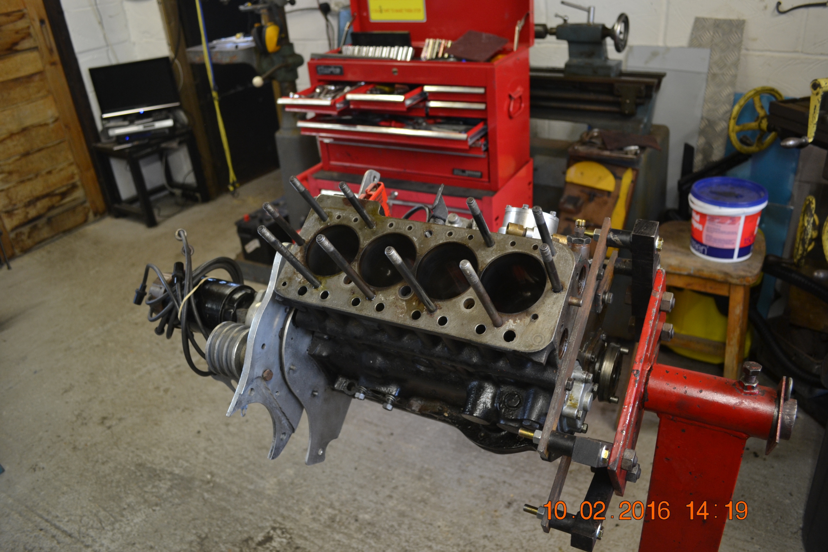

We got the engine up on the stand & stripped the head down & took the sump off.

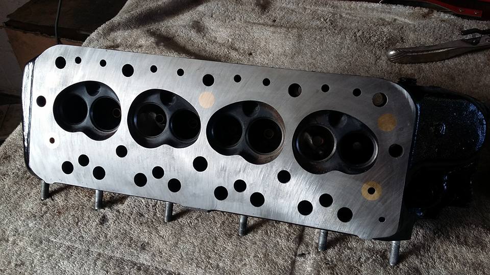

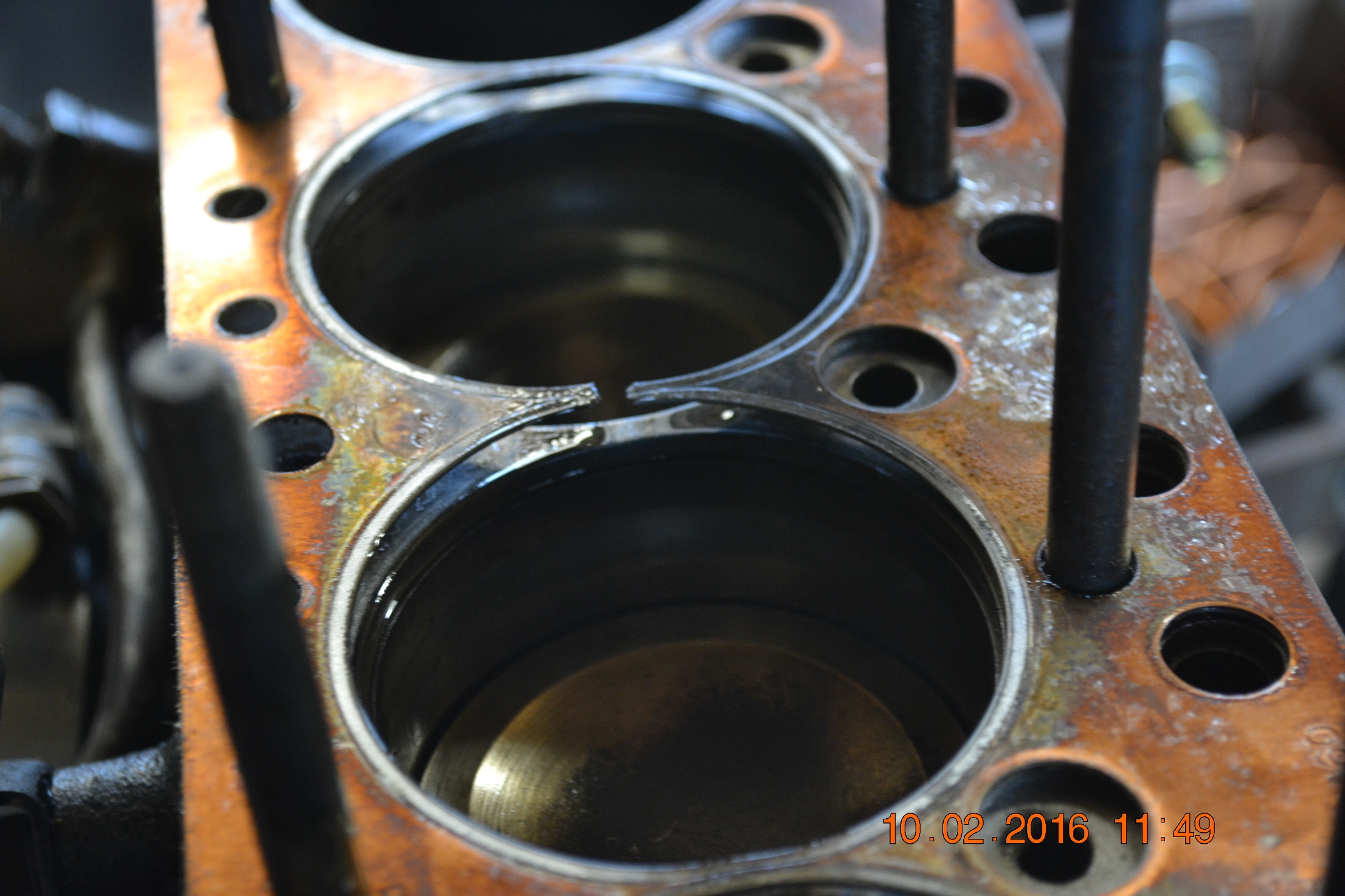

Upon removing the head, we discovered confirmation that our initial thoughts were correct as you can see from the pic below, a blown head gasket between cylinders 2 & 3 (the narrowest gap in the engine!).

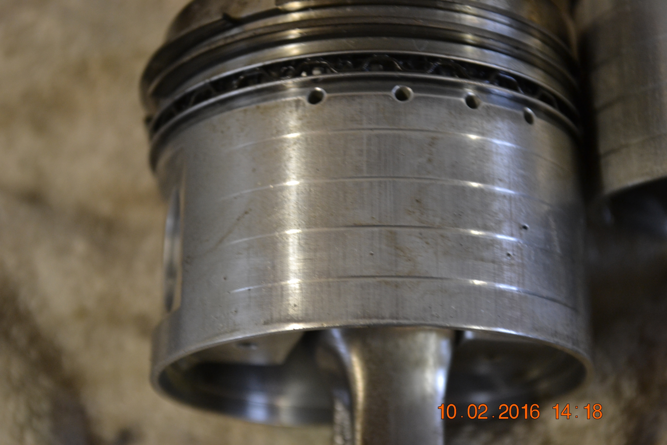

Incidentally, this is one of the two gaskets fitted, this one is below the spacer plate & there's an identical one above it! Naturally we checked the bores & the pistons & rings & whilst nothing untoward was found, we have fitted new rings just in case. Dave took the head, pistons & rods down to a BMC guru near him for expert analysis & the concensus was that the bearings would go again but new rings would probably be wise at this stage, even though there were no obvious signs of faults with them.

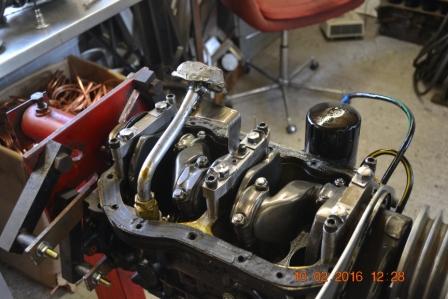

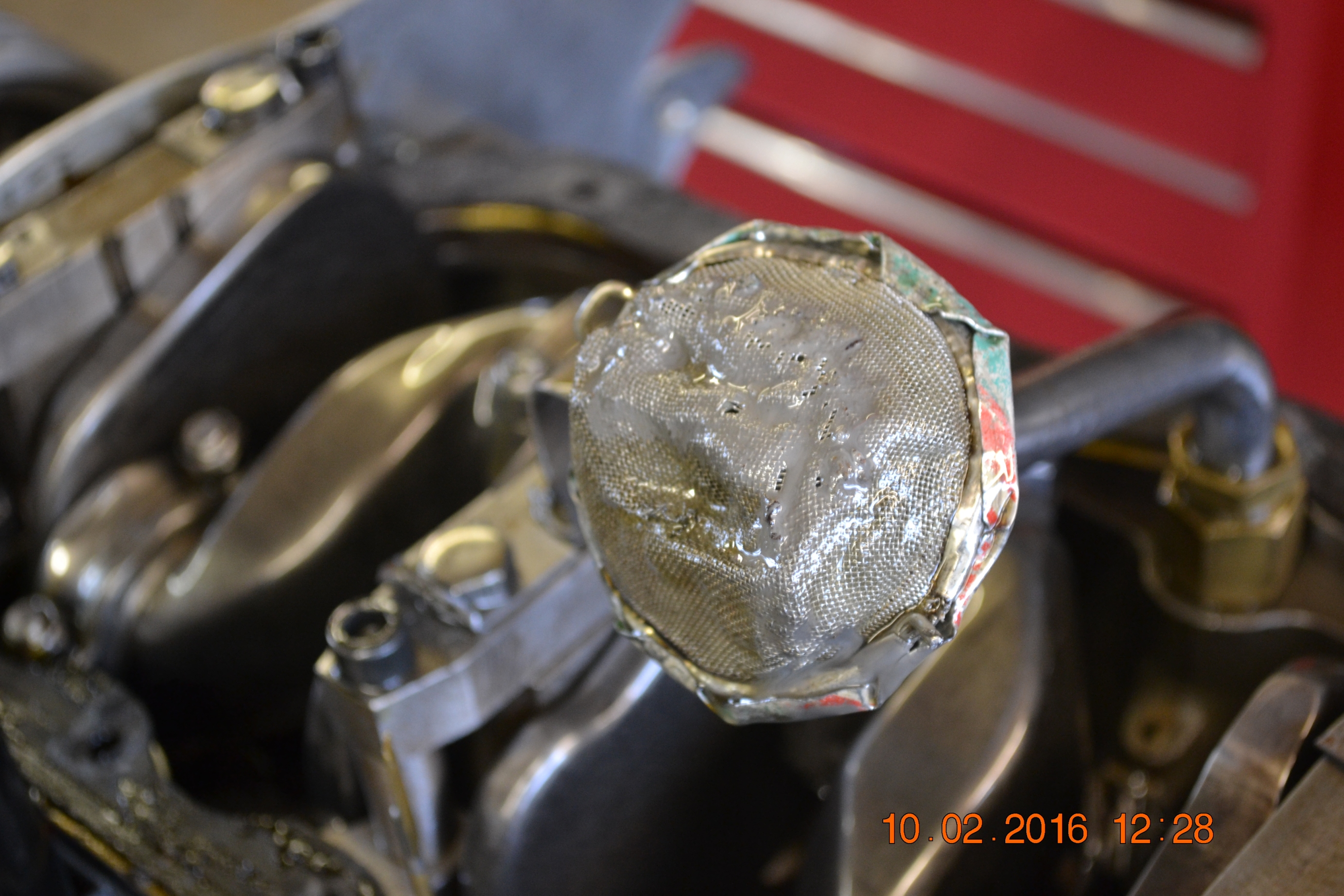

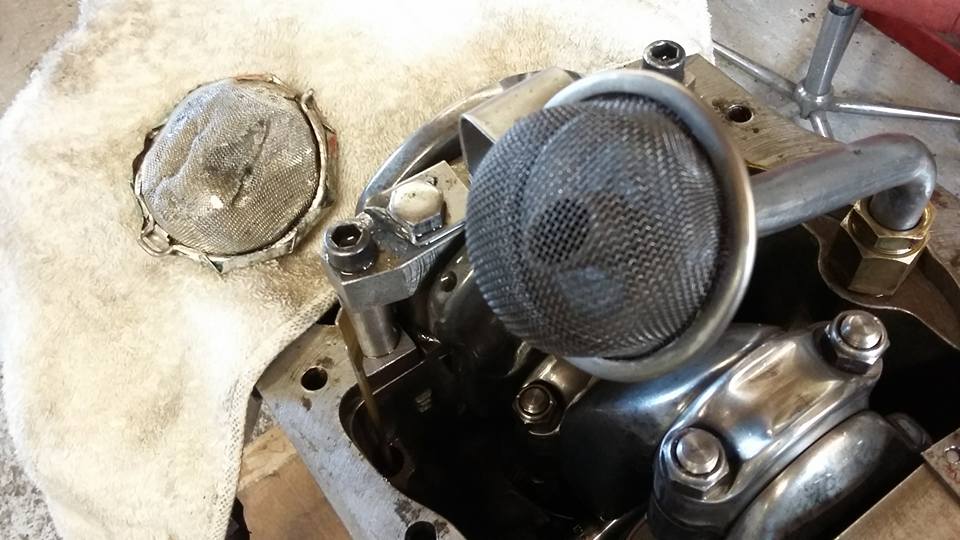

Whilst underneath, we took the opportunity to address the rather sorry looking oil pickup filter & fitted one of Dave's ones he manufactures for Caterham 7s. We also marvelled at the bottom end girdle we had seen before when we removed the sump in situ, the amount of work carried out to the rotating parts etc is very reassuring!
Oil pickup filter.jpg (74.47 KiB) Viewed 16302 times
The head was cleaned & checked & found to be slightly warped so 6 thou was skimmed off & then, because we decided to fit superior Iskenderian double valve springs, discovered that they were a few thou taller than the original ones (Special Tuning, we think) so had the valve pockets re-machined to accept them. According to the BMC guru, the pistons are also +20 Special Tuning ones, although we're at a loss to understand why there are 4 holes drilled just below the bottom ring land!

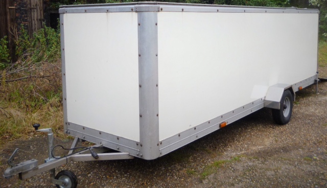

I didn't really need a new trailer as we've modified Dave's truck to take it & his altered (& Scott's JD as well) together, but if I wanted to take the dragster somewhere on it's own without the hassle of using Dave's truck, I can now using this. Plus, if Dave needs the space, we can load the car in the trailer to give him more workshop space, or even use it himself for Scott's car or moving long thin things around!!

When I first had the car it had an AP twin-plate racing clutch. This was too fierce and resulted in a lot of gearbox and back axle breakages. I built a slider from Russ Carpenters plans but only had room in the can for one plate, so even with a lot of weight on the arms it worked, but slipped too much. I then fitted the clutch which is in there now but only raced it a couple of times with that clutch.
I must apologise for the clutch release mechanism, I made it up out of bits to try the clutch and never got around to changing it. Tight in there isn't it.
Glad the gearbox problem was just a lose pipe.

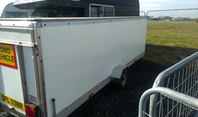

Most of the work lately has been on the trailer to make it fit & usable for the car. Fitted proper tie-downs front & back using some alloy checkerplate panels kindly donated by my fellow team member Dick Hogben. This was because the floor board near the back was rotten & beginning to degrade & wouldn't have been a suitable place to mount tie-downs to. With what was left over, I made a similar plate for the front to mount the electric winch & the front tie-downs so I feel confident it won't break loose in there.
I now have a matching checker-plate box to mount on the draw bar to house the battery for the winch & the interior lights (when I get around to fitting them). Next job is to make an alloy angle framework inside the front bulkhead to have a shelf to carry stuff on over the front wheels, originally to hold the battery but the weight meant it was safer to put it outside.
