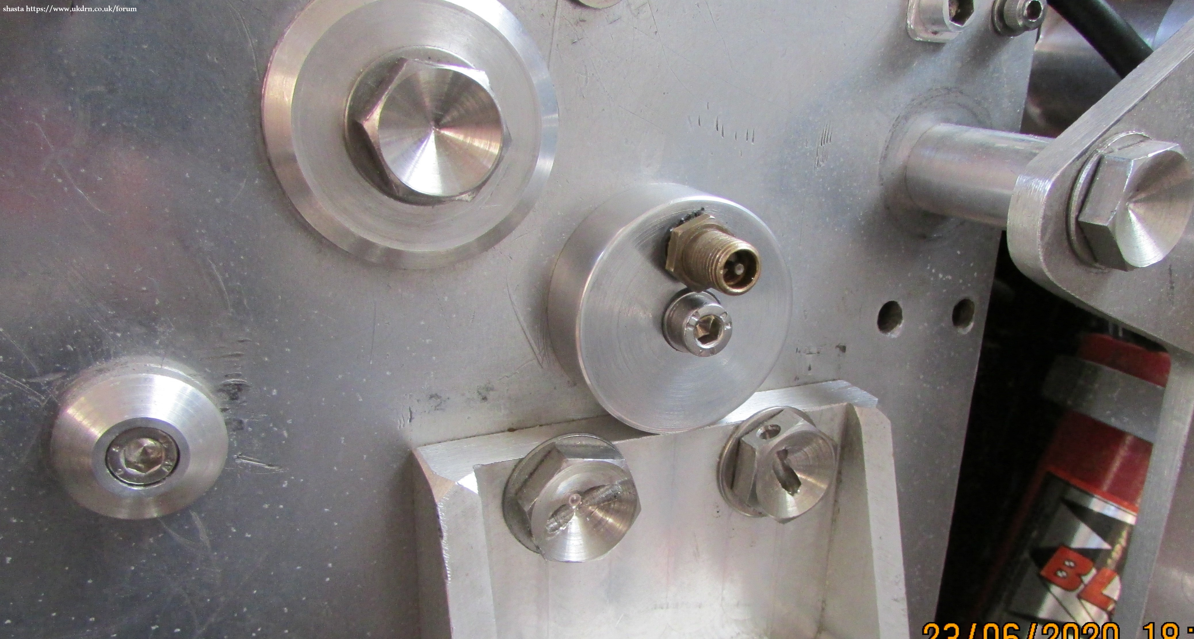

Tackled an item that's been bugging me, namely the position of the compressed air reservoir bottle for the gear change mechanism. It was stopping the seat unit from locating properly and was difficult to pump up with the seat in place. The best place appeared to be under the ignition box, so firstly two circular clamps were turned from a piece of thick walled aluminium tube holding it off centre in the lathe so I got a thicker side for the mounting screws to go into.
I decided to fit the filling point remote from the bottle, and a pre-drilled large hole on the side transmission plate proved the ideal spot. From ali bar, two pieces were made up, with o-rings on each to seal against either side of the transmission plate and bolted together to seal them against the plate. The outer piece has the filling point now in a convenient place and a couple of new lengths of plastic pneumatic tubing and the installation is done, a definite improvement.
Whilst I had the ignition box off, I noticed a sticker on the bottom, stating that the system must NOT be used with solid core plug leads. Oops! Now have to get about 16 feet of helically wound carbon cored ignition lead and make up another 9 leads...great!!

Filling point on transmission plate
