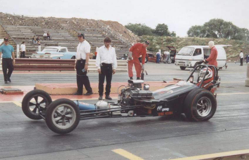

Lastly attached a rare picture at half track just to show how little weight is on the front axle note the height of the chassis from the deck.
Wonder where all the other little bits finished up that I made for her, twin stainless oil catch cans and stainless rocker box plugs and teardrop water gallery plugs etc.
Ron
High Fever at half track
Picture 1530.jpg (57.59 KiB) Viewed 10886 times
 #9952  by PhilSweeney
would advise against clicking off and coasting with an auto box, no running engine = no trans line pressure and can wipe out a bushing or bearing at speed. Also if you have a brake and chute failure, your last resort of momentarily engaging the transbrake is useless if the motors killed.
