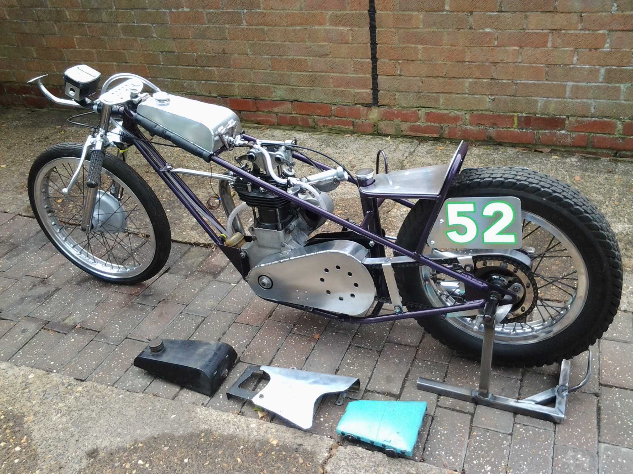

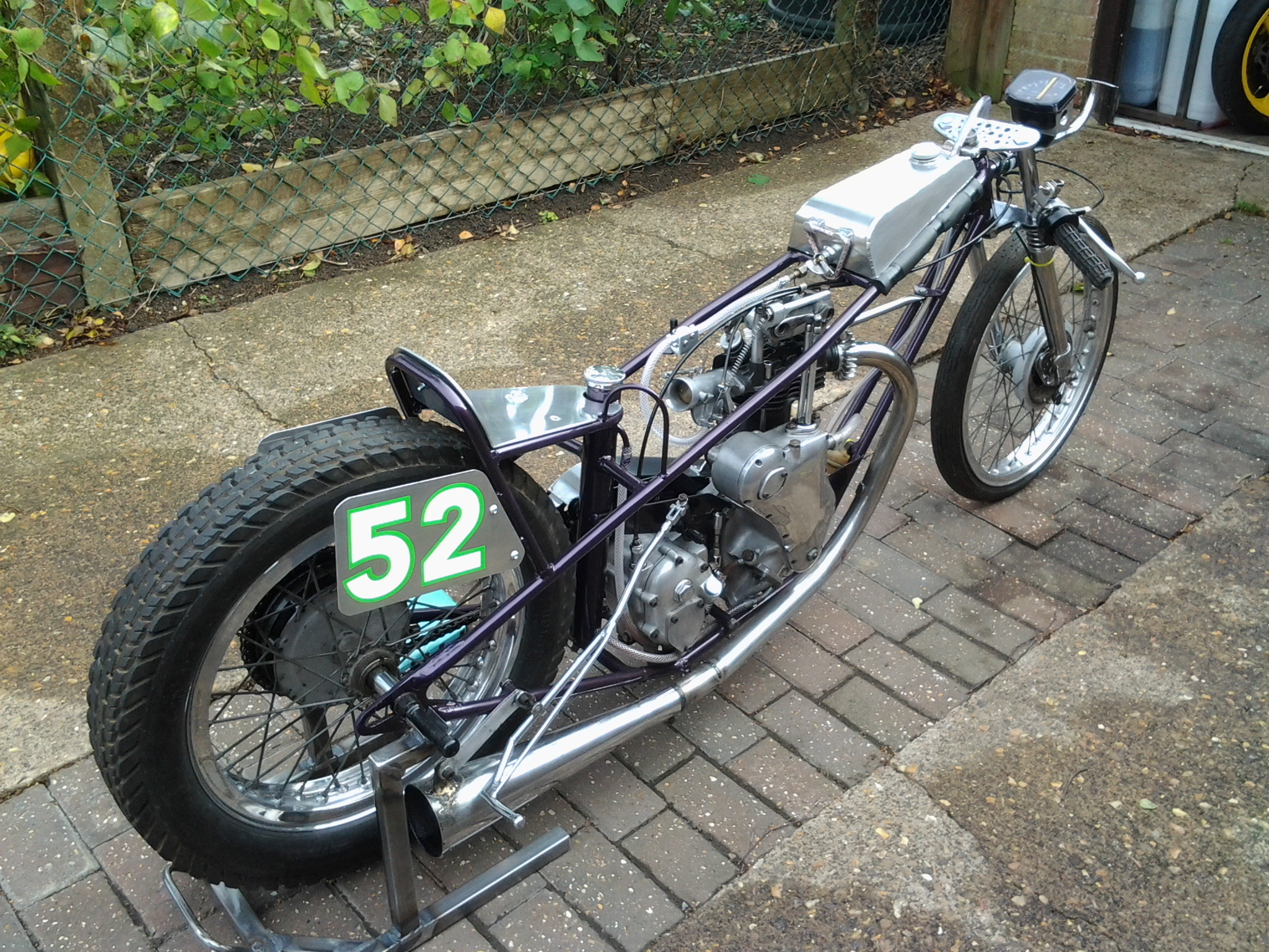

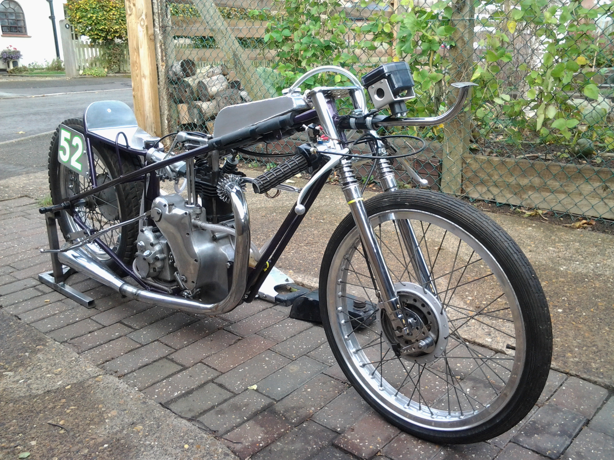

Roy Webb's has been having anther dig around and with Colin Fallows doing another fantastic job on the restore
we now have another great looking bike back in action.
It’s a Velocette that apparently has held some records, it runs nitro through a fuel injection system
If anybody has any more info then please let us know.
 #37506  by stormbringer
Re: Fuel Injection. It looks like a Wal Phillips Fuel Injector. He was based in the Old Kent Road. I tried one of those on my Triumph 500, it wasn't successful. I recall it was more a float chamber-less carb than proper fuel injection as there was no pump involved, it used a butterfly rather than the normal slide set up. I believe that it ran OK fully open but they were a bit temperamental on part throttle. I ended up fitting twin Dellorto's which were the best for road use.
 #37512  by ukdrn
stormbringer wrote:Re: Fuel Injection. It looks like a Wal Phillips Fuel Injector. He was based in the Old Kent Road. I tried one of those on my Triumph 500, it wasn't successful. I recall it was more a float chamber-less carb than proper fuel injection as there was no pump involved, it used a butterfly rather than the normal slide set up. I believe that it ran OK fully open but they were a bit temperamental on part throttle. I ended up fitting twin Dellorto's which were the best for road use.
Thanks for the info Pete.
Do you recall if many of these used for drag racing?
 #37513  by jaytee
Alf Hagon used the Wal Phillips injector on the unblown and blown version of his JAP bike also on a Hagon Honda that featured in Drag Racing and Hot Rod magazine, he sold the Wal Phillips "Dope" Injector plus Avon slicks and Shorrocks superchargers from his shop in East London, I've seen them fitted on a few cars as well, I guess Nick will have info on them
 #37514  by timetravel

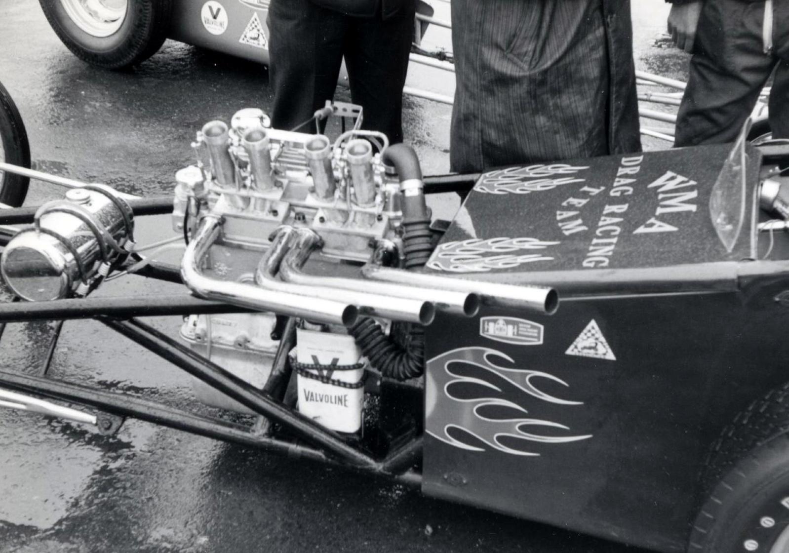

I think most of the injected small engined dragsters in the 60s used either Wal Phillips or a home-made version of it...

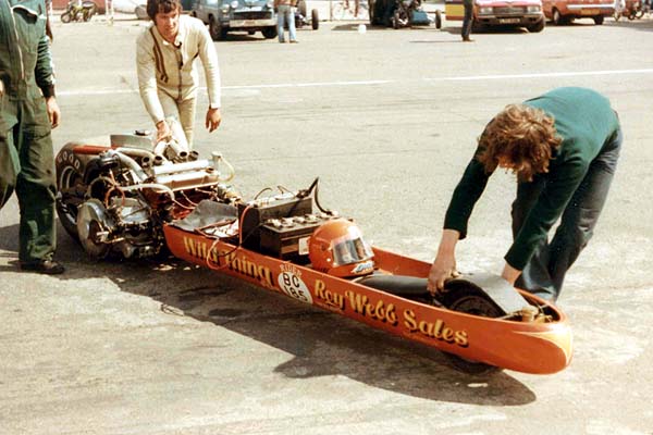

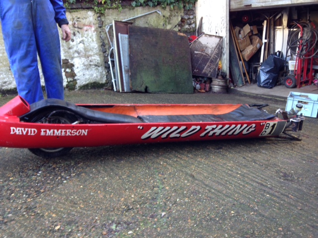

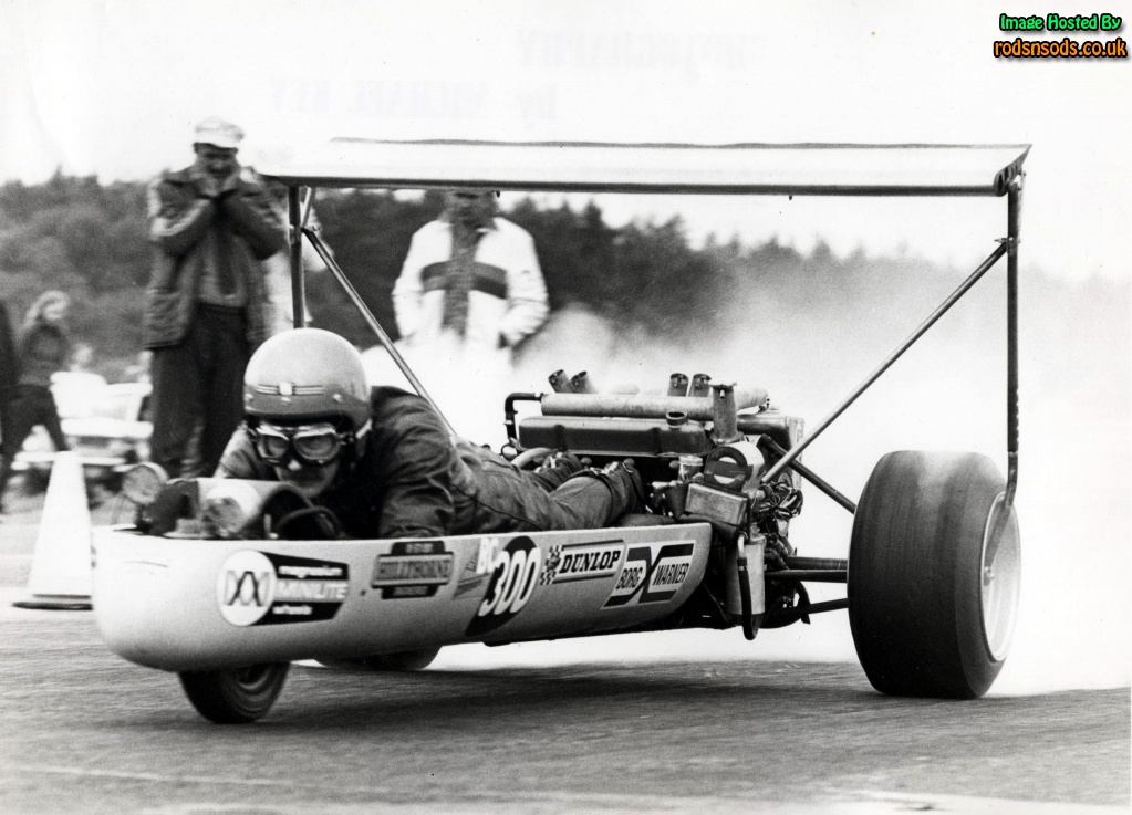

Roy and Julian have been having another root around have have found and decided to restore one of the most aptly named machines ever to have graced any drag strip and that is the "Wild Thing" 2 or 3 wheeler.
Angus McPhail built it as a test piece for Jade Warrior and to break the three wheel land speed record.
It was originally called McPhail's Nail but went on to be known more commonly as Wild Thing.
Angus made many of the engine internal parts and made virtually all of the gearbox. It runs the ford pre cross flow engine supercharged on methanol. Roy put a V6 Renault engine into it at one time!
The front wheel is a Vespa piece with cantilever steering.
Roy and Julian have all of the machine and can build it into either it's original three wheeled version or the later two wheeled version.
The intention is that it will be re built and run by Graham Sykes of the Syko three wheeled bike fame.
Graham is a superb and unique engineer and loves historic sprint and drag bikes as well as being at the forefront of current design and building of many current unique vehicles and parts. He also holds the current three wheel top speed record.
Julian has kindly promised to keep me updated on the restoration and I will post updates as I get them.
Being a lover of all things wild(no pun intended) I cant wait to see this finished.
As she came out of the shed.
As she was.

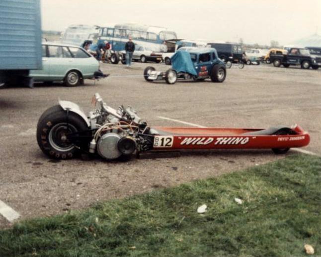

Look forward to seeing that out again. Here's a pic I took at Long Marston 1983...
